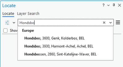

Are you zoomed to an extent that covers both cities? Are you getting any suggestions by typing the street name or only when you include part of the house number? Are you expecting to get results like the suggestion in the screenshot?

Are you expecting to get results like the suggestion in the screenshot? Yes that would be the end goal.

In the meanwhile I have found that I wouldn't get results for certain streets due to the lines being multipart. Once these lines where converted to single part I would get my results.
I do still have a minor issue with the following:
When  I fill in the number I now get two results, shouldn't the street result be removed when I add the housenumber?
ShanaBritt
@AndreasB I'm surprised that you did not get a warning message after building the locator about the multipart lines. The results in your screenshot looks like a StreetAddress and StreetName candidate. If you do not wish to have StreetName candidates, disable StreetName as a supported category in the locator properties.
