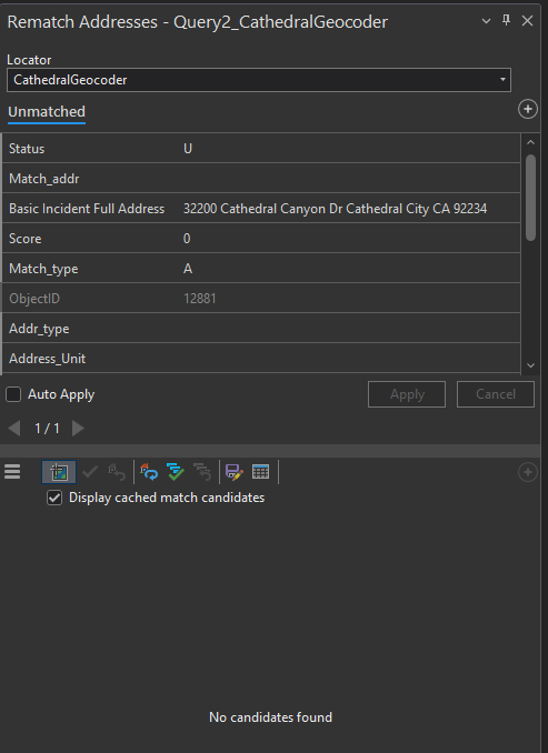

I am attempting to Geocode some addresses, but am getting poor results from the Geocode Service but accurate results from the Locate Toolbar using the same Locator used in the Geocode Service.
IE:

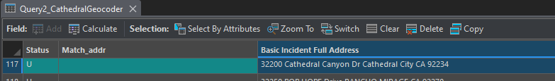

Table Date (single field)  32200 Cathedral Canyon Dr Cathedral City CA 92234
Table DataTable Data

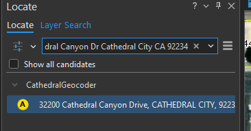

Locate (Using same Locator published as Geocode Server):
From LocateFrom Locate
Rematch Addresses of above table: No Available CandidatesRematch AddressRematch Address
