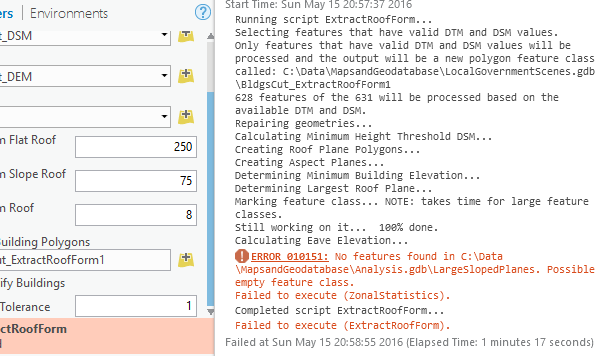

Trying to run the task for LOD2Buildings. I have created all the surfaces DEM, DSM, and nDSM following the first set of tasks. Now when i run the Roof-Form Extraction process I receive the following error.
Figured i would check here and see if anyone else ran into this problem before i reach out to esri. Thanks in advance.

Does any of your buildings fall outside your dem?
I was getting an error because of that.

I created a test area and clipped the building footprints to that AOI so some of the buildings would actually intersect the dem.

I ran the 'Extract the roof forms of buildings' task on my arcgis pro 2.0 with a test licence for 3D Analyst and Spatial Analyst and got this Report (see below).
DTM is calculated from classified LIDAR data (ground Points).
DSM is calculated from a shape file (Surface model) which was transformed with lastools - 'shp2las' into LAS
the routine worked quiet well with the esri tutorial data from Portland.
extract roof form - failure report
Does anyone has a solution für the Problem?

My fist thought is that this process does not support using commas as decimal points. Please try using a period instead for your input parameters, and see if the issue persists.

thank you! I already found out, that it won't work with a comma.
