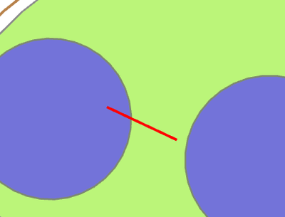

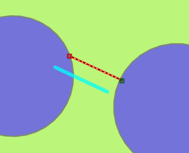

I have line data that is not showing in the correct location. The example below shows the line not between the 2 polygons. If I click on it to edit the vertices it shows it at the correct location but when I click away from it, it's back at the wrong location again.
This is happening on a load of lines, they all look like they are not showing correctly but when I try to edit them they are!

Could you ensure if all the layers and Map are in same coordinate system, and the features are stored as Geodatabase Feature Classes?
Assuming you have followed the above point and the issue still persists, could you add the data in a new map?
Remove the line layer from ArcGIS Pro. Save the project and close ArcGIS Pro. Open the Project, and add the line feature class again.

The data is stored as a hosted feature layer in Portal in WGS 84. All the other layers stored in the same location behave according. The basemaps are in a different projection.
I tried removing it , saving the project, closing, opening it and re-adding it but the problem still persists.
The only way around it was to create a new project and add the layers again. That seems to have resolved it.
Thanks for your help.
DevRobinson
You wouldn't happen to be working in a 3D Scene map, would you? This can happen if your features do not share the same Z values as the ground elevation upon creation.
