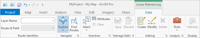

Updating this thread for completeness and available releases as of 2022.
  • ArcGIS Pro 2.9 introduced a Linear Referencing tab on the ribbon that provides a new way to manage, visualize, and process measured data. Additional functionality to update route meaures has been introduced.
  • ArcGIS Pro 2.9  Find Routes to search by providing a Route Identifier and measure value without having to know the exact coordinates of the routes.
Linear ReferencingLinear Referencing
  • ArcGIS Pro 2.4.  viewing measures was added to the Navigation > Explore tool and includes additional measure fields in the pop-up display. Identify Route tool capabilities are documented as View Route measures.
Identify MeasureIdentify Measure
The above functions do not require advanced LRS licensing like Pipeline Referencing or Roads & Highways. Related Blog: How to choose between linear referencing and location referencing
