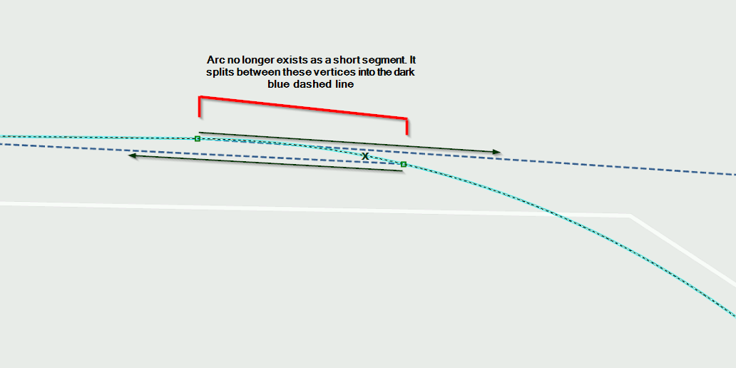

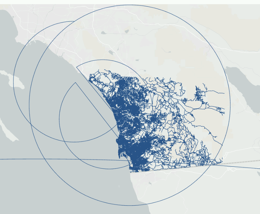

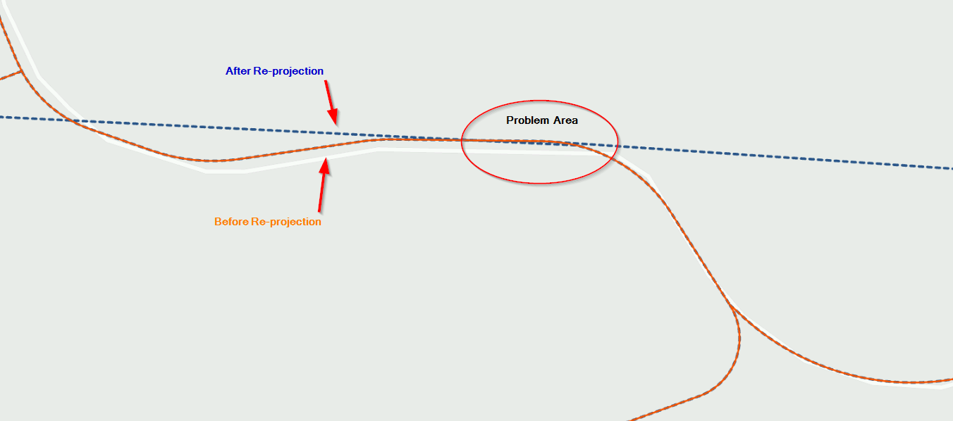

I've a bit of an odd issue. I have a enterprise line feature class of road segments with a projection of NAD 1983 StatePlane California VI FIPS 0406 Feet. On a weekly basis, this dataset is re-projected to WGS84 so that it can be utilized in NG911.During re-projection, I'm finding the same four segments, week after week, become errant and creating these giant arcs (image 1). When I zoom in to look at how the giant arcs are created from each feature (image 2), it happens to be a single segment of the feature that was created using the line type circular arc (image 3, the "problem area" from image 2).

Ah that's an interesting one!  Does check geometry show anything?
Densify on those segments would probably fix the issue, or convert to shapefile then back before the reprojection.

Haha, an issue I encountered a lot in a previous job.
As per @DavidPike then densify prior to reprojection is the way to go, be that manually adding a few vertices along the offending lines (which I suspect have exactly two vertices currently, one at either end). By way of explanation, for line features or straight line segments of polygons then ArcGIS doesn't reproject the line itself, it just reprojects the constituent vertices. So (over simplistically) the more vertices you have, the better the reprojection result, because each of those points will move position and allow a line to be drawn connecting them.
I used to have lots of fun with dual vertice straight lines drawn across the poles then reprojected 😂
__JackCharde__
Doh! Should have used check geometry first. Looks like my four offending line segments are short, which is likely causing the issue. However, I think the segments might already be densified since ST_Geometry doesn't support true curves.
