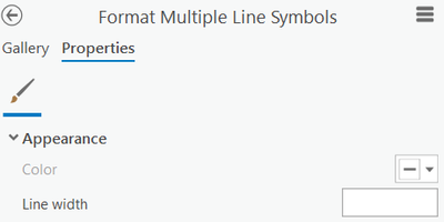

When I click on the link ( BUG-000108431: When formatting all symbols, the buttons to modify s.. (esri.com) ) it says its fixed in version 2.7. I have 2.7.1 and I cannot format unique values for all features - like offset or additional symbology options available when selecting one value at a time. For certain projects I need to see each polygon - so being able to offset where many have overlapping segments would be helpful. Doing it individually for over 100+ polygons would be too time consuming. Am I missing something?
DavidWheelock2
@KoryKramer, the bug referenced above now indicates that this has been implemented, but it has not.  I, too, am using the latest update 2.7.2.  Would you check on this issue and let us know what's going on?

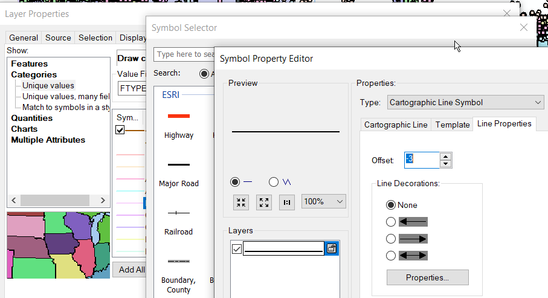

For example:
When using ArcMap, if I select Properties for All Symbols, I can set ALL of the potential properties of a line, or other feature type.  Here, I have set properties to Cartographic Line Symbol and selected Offset.
However, in Pro, today at 2.7.2, if I select Format all symbols, the ONLY thing I can adjust is line color and width.  There's just no comparison.  This is an important feature.
