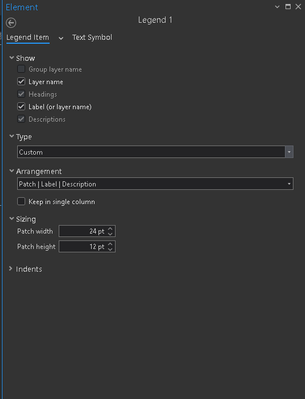

Hi there, is seems as this solution is outdated. Does the current version of ArcGIS Pro have a different option?
KeithAddison1
Pro 3.1 - This option keeps disappearing from the menu.  It was there for me just yesterday, I haven't updated, not a thing has changed.  Now what?  Back to ArcMap yet again.
