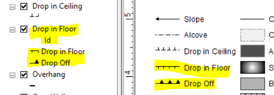

I am trying to figure out how the legend below, which has not been converted to graphics, looks like it does, i.e., "Drop in Floor" and "Drop Off", which are actually in the same layer, are shown as independent layers.  I tried to recreate this in another map and couldn't, even though all of the settings in Legend Properties are identical.  How did they do this?  Thanks!
                    TOC                                                                         LEGEND

Looks like the layer with multiple classes is dropping the layer name, where layers that only have a single class are placing the layer name to the right of the legend patch.  Depending on how your legend is defined this could be expected.  Please refer to http://desktop.arcgis.com/en/arcmap/10.3/map/page-layouts/working-with-legends.htm#ESRI_SECTION1_204... for more information on how to nformat your legend.

Hi Tom,
Yes, so sorry to not have dug deep enough before posting - I have managed to avoid messing with styles before, and just forgot about the option.
Thanks so much for your help!
Amy
