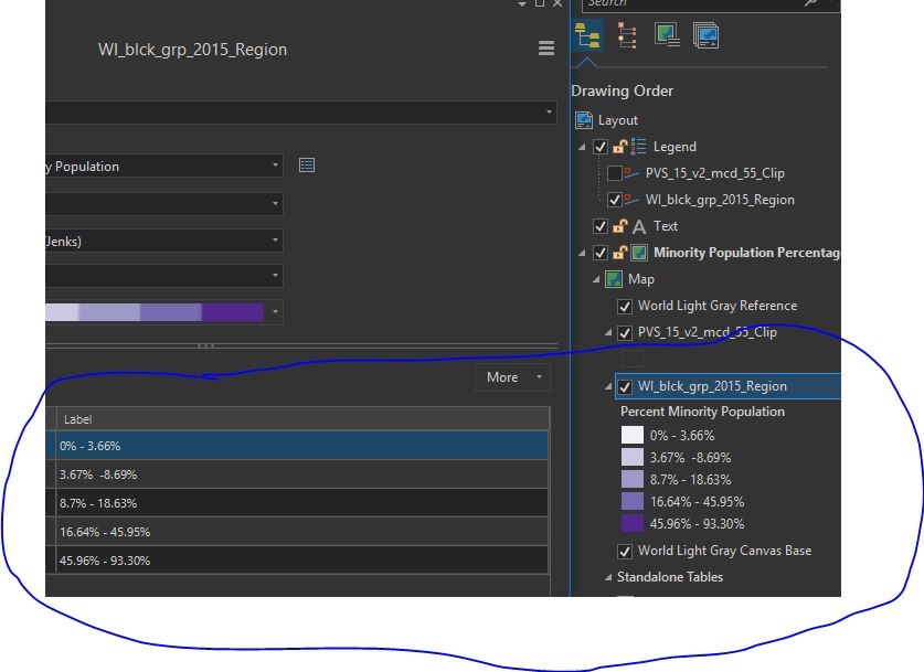

So, I have my label values symbolized in my feature class like this:
feature class symbology labels
The problem is, when I insert my legend, ArcGIS Pro drops the hyphen (along with its leading and trailing spaces) as well as the second percentage sign:

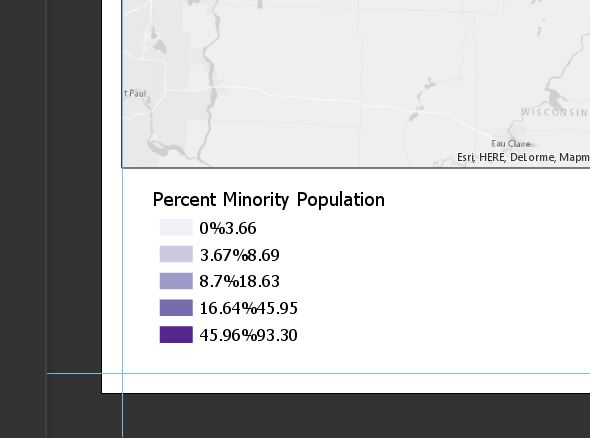

Legend
If I try to convert the legend to a graphic,to manually adjust the labels, I can insert the spaces in the hyphen and spaces without a problem. But if I try to add a percent sign, to the upper limit, it comes in as \n.
manual edit
How can something as simple as editing a legend/graphic be so cumbersome? Do I reelly need to insert seperate text boxes just to format my legend. This functionality worked great in Arcmap, why is it so hard to work with in Pro. If anyone has any advice it would be greatly appreciated.

Dan PattersonJayanta Poddar‌ either would work, but they are kind of workarounds.My solution was to fix the issue in Illustrator. When I exported to .pdf, the hyphens were present but they were placed directly beneath the first % sign. I spent too much time doing something really simple, that shouldn't have even been a problem in the first place.  ESRI needs to address the underlying problems with ArcGIS Pro and improve the functionality, if they actually expect people to adopt the platform. notreadyforprimetime‌
