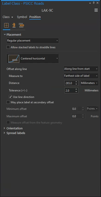

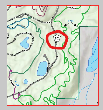

DEAF_PROBERT_68
Honored Contributor
When I fixed the problem for the 9C symbol in the picture above here.
Here is what I did :
Here is what I want this 9C symbol, because it is a perfect place to read it and does not affect with other layers...
