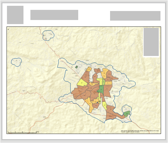

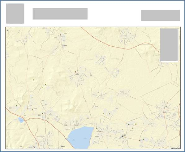

I have a Layout which I need to set to export several map extents as PDF. (not part of a series)
If I do right-click Zoom to layer > Activate map frame > them zoom and center to my liking > close and back to layout
the properties of the map frame do not change making the PDF a bit more than useles...
I found a workaround by manually adjusting the center and scale, but it is very time consuming and error-prone
Any idea on how to make them link to each other?
PS I'm running ArcGIS pro v1.3 on a windows 7 OS.
Here's a snapshot of what I mean: (greyed out areas for privacy, nothing important there)
What I intend to have on my Layout
PDF output

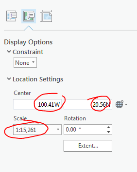

Fortunately, I found a workaround that is a bit messy, but does the trick:
Position the map as it were in the layer > Position the mouse cursor in the middle of the map > note down the coordinates of the center > Go to the Layout > Element > Map frame > Properties > Type down the coordinate center. > Adjust position and scale. accordingly to create a beautiful and useful map.

Using the RED button does not work/update the map frame. Clicking on the GREEN ones will work.
I was not aware of them, so I was only using the red link to go back and therefore having nightmares...
