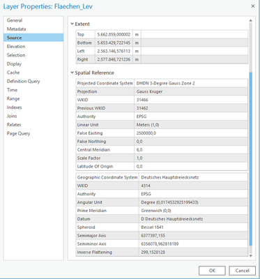

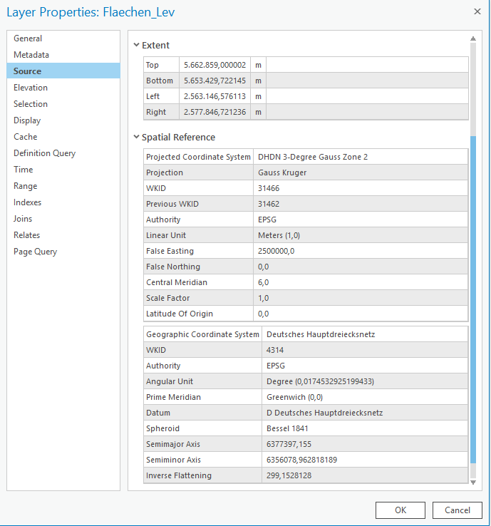

Hi, I have a  problem with layers not matching. I have two shape files and this two shape file should be overlap each others. I treid all the way I know with Define projection/Projection tool.  below is image first one projection settings

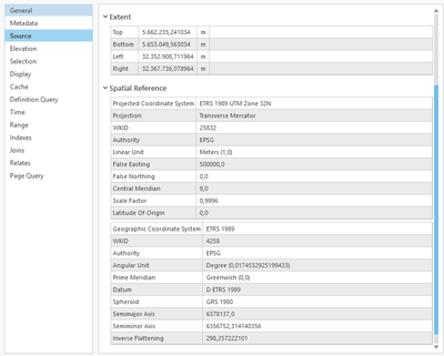

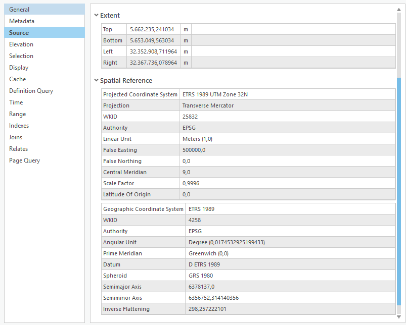

 second layer settings is..
what is actul problem is here ?
