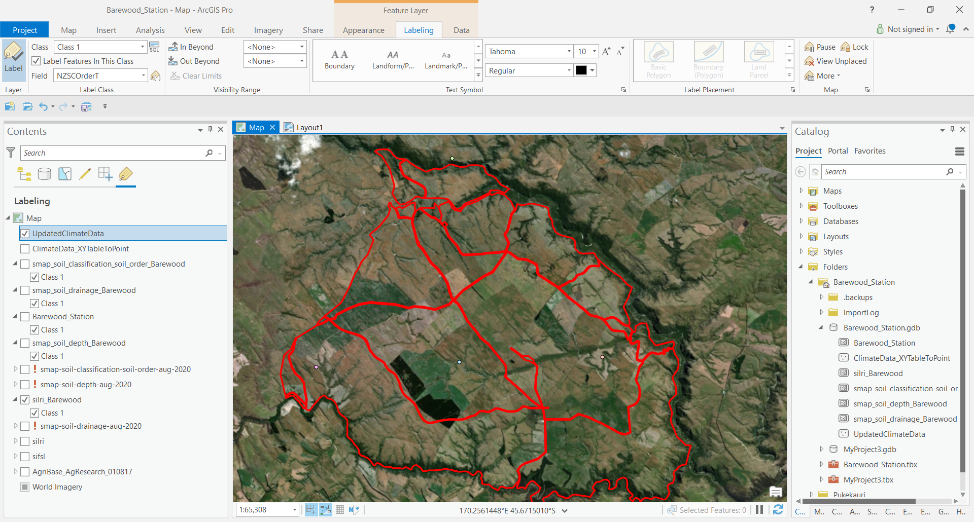

Simple question - Labeling tab does not becomes active when I select one of my feature layers the others are fine. I'm assuming there is a setting in this particular feature class that somehow makes it different to the other feature classes. Can anyone shed some light on this please?

Hey @karreno that does look a bit odd, looking at the screenshot t, I'm assuming the layer selected is the point featureclass, it doesn't appear to have any "label class" attached to it as well, from my understanding all features have at least one label class.
And yeah also doesn't appear to update and reflect that, there was an old BUG with a similar is for scene's: BUG-000093727 appears to be fixed now though.
If we bring the same feature layer into a new map or project do we still experience the same issue?

Hi Keiran, thanks for your reply. Yes it has no "label class" I tried to create one but it won't let me. The suggestion to bring it into a new map worked and it is now working fine.
