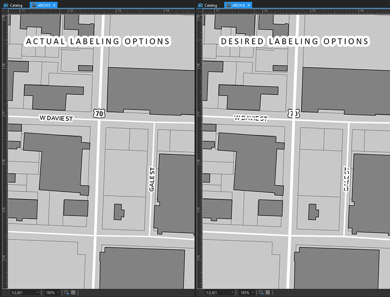

I have been working on creating a custom basemap and I have run into an issue which I think is peculiar. Why is there not an option (or I cannot find the option) to put labels behind feature classes? I know this may not be ascetically pleasing, but I really want this option with actual labels and not converted graphics. I would like to preserve the quality of the text vectors. This would be really useful when I have a lot of features on the map and the road labels are covering them and all I am wanting with the road names is a general sense of the location. Am I missing something and this can be done somehow or is this a really crazy pointless idea?

Not sure how you made that second map (meaning maybe you've already done what I'm going to suggest), but the only thing I can think of would be to convert your labels to annotation and then have the anno draw underneath the features.
What you describe as the reason for doing this seems odd to me.  It sounds like things are getting "cluttered" and unreadable in your map... I would think that a better option would be to thin out your labels (or even features) at certain scales to keep things clean.

I really want to avoid having to convert the labels to graphics or annotations (I created the above image in Photoshop). I think what I am wanting to do is not possible. Also the idea may seem strange to some that I would want to be able to do this with labels however, I think it is something that makes sense and should be a simple checkbox option. It is odd that the option to do this has never been developed if even for just a little more flexibility. While I do have a lot of features on the map and at times they do get cluttered (there is just no way around that) the main point of this would be to preserve the vector quality of the label with zooming and panning while not obstructing the more important features I need displayed. I have already developed complex labeling rules with VBA and SQL for displaying specific features and I have the scaling rules as well. I pretty much have everything else is exactly how I'd like to display the map. It seems like I may have to use what you suggested with the annotations. Thanks for the reply!
