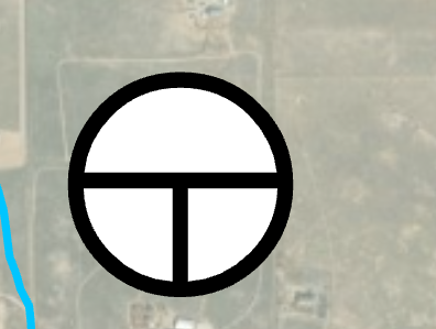

Hello, I am very new to ArcPro but have a novice level of experience with ArcMap.
I am trying to automatically label a shapefile in ArcPro with information from three different fields in the shapefile.  The screen shot below shows the shapefile I am trying to label.  I would like each of the three fields to occupy a different section of the partitioned circle. I know I could place lines of text on each section of the circle, but I would like to be able to do it automatically if/when I change the values in the various fields. I also am aware of using expressions to write a bit of code to place labels, but I am way over my head on how to do that.  If someone out there knows how to write code to have an expression do what I am looking for I would be very appreciative.

Hi @dharder13,
The use of Label Classes  would be worth considering in this case.
You will be able to create a label class for Field 1 a label class for Field 2 etc.
Annotations may also be worth exploring as they allow you to modify individual items of text compared to Labels.
