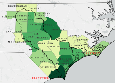

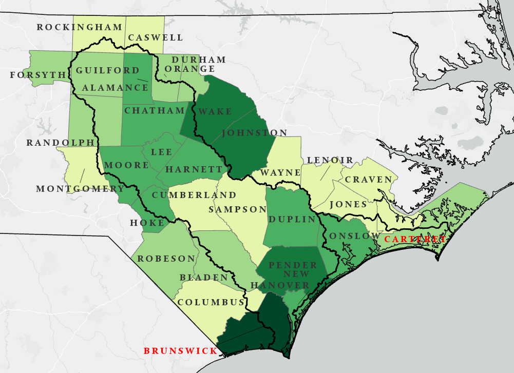

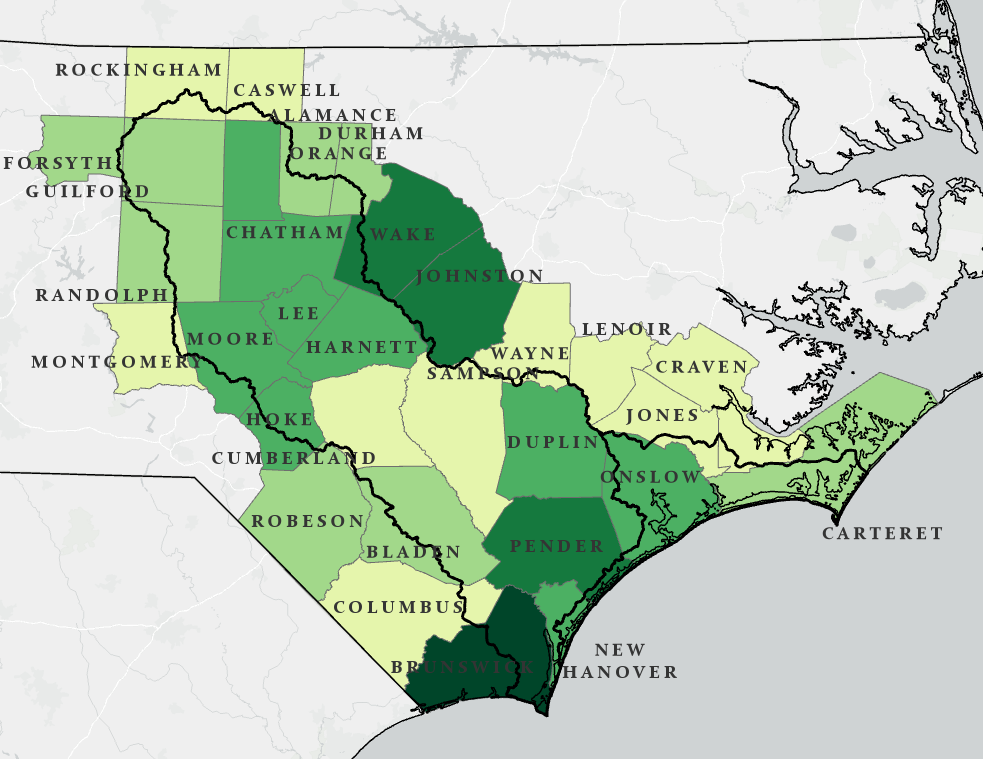

Hello - I've run into something weird. When adding a Callout line, some text turns bright red. Is this a new way to show an issue with placement? I'm ultimately fine with where the labels end up for the most part, but I'd like the text to remain the same color.
I have one label Class for the map, so it's not an issue with conflicting classes.
