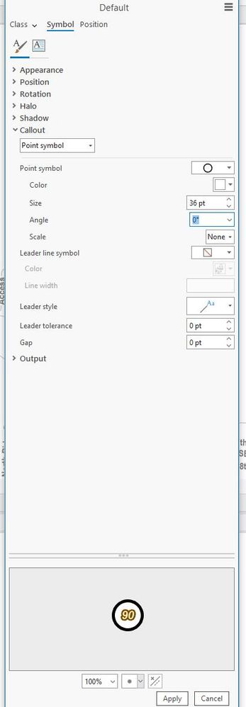

Hi there,
Just wondering how to put a label inside of a dot in Pro, like below?  Essentailly stacking the label on top of a point/dot/circle.  I forget exactly how I did this in Desktop but I don't remembre it being a huge hassle.  Having trouble figuring out where / how to do this in Pro.
SteveCole
Honored Contributor
Under the labelling properties, give the symbol a callout and choose point symbol as the option. Change to taste:
SteveCole
Honored Contributor
sgambrel_Bouldercounty
Perfect, That's exactly what I was looking for.  Thought I had checked there but I guess not!
