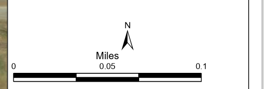

I am creating a Map Series within ArcGIS Pro 2.9.10. I would like to keep the size of the scale bar consistent across pages. I am fine with the scale values changing as the pages are at different scale, I would just like the scale bar to not resize on each page. Below is an example of how the scale bar resizes from one page to the next:
Page 1:
Page 1 has my ideal scale bar size/placement

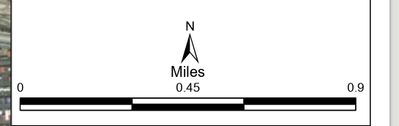

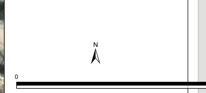

And here is Page 2:
On Page 2, the scale bar extends past the extent of the layout which is of course not ideal. For reference, page 1 is at a scale of 1:1000 and page 2 is at a scale of 1:9000. I used the fitting strategy of "Adjust Number of Divisions" for this example. I have also tried "Adjust Division Scale Value" but that fitting strategy had similar results. Any ideas on how to fix this issue? TIA.

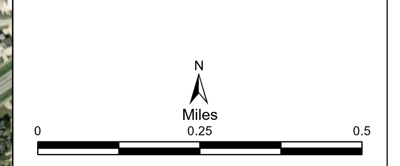

The result of Adjust Division Value for me is not awful, but the scale bars are not uniform in size from page to page:
Page 4:
Page 5:
I am wondering if there's another setting I need to toggle somewhere or if I'm just missing something.
