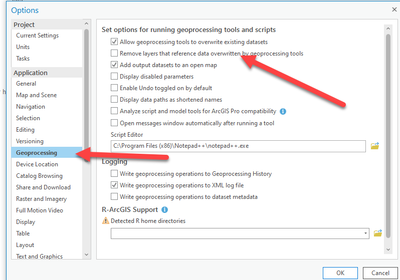

In the options, if you un-check the Remove layers that..... setting, it will update the layer, but not remove-re-add it to the map.
This way, it stays in the correct order, and retains it's symbology, etc.

.. and remember to save the new settings before running the analysis.
