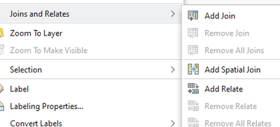

So when you're performing joins, are you using Spatial Join by chance? This should let you join features to one another spatially, along with that, you could use the add join and add spatial join like this here:
If you could give an example of your workflow or maybe a list of steps, we may be able to see a little deeper into what's going on!

Thanks for your response! I typically use the Join Field Geoprocessing Tool, or the Add Join as you have showed in the screenshot from the contents pane. I would use Join Field Geoprocessing Tool when there are specific fields I want to transfer. As to my knowledge using Add Join from the contents pane joins all fields (please correct me if I misunderstand the full scope of that process).
I don't normally use the Spatial Join option, would that be a better way to approach a workflow where I need to join multiple tables together at the end?
