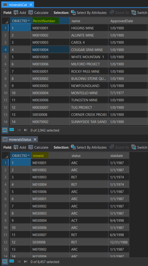

I am having an issue using Joins with ArcGIS Pro.
The goal here is to join the two tables by the 'PermitNumber' field in the 'mineralsCat' table and the 'mineid' field in the 'mineralsStatus' table.
See table below:
 For context, these are permit numbers for mineral mines in my state.

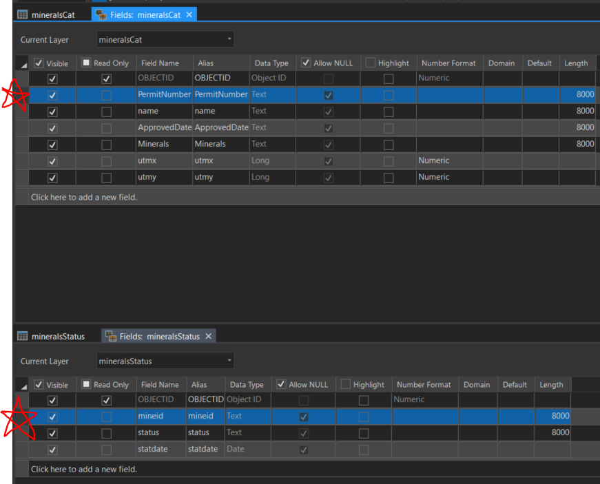

  • That the field types are the same (both text with 8000 length value)

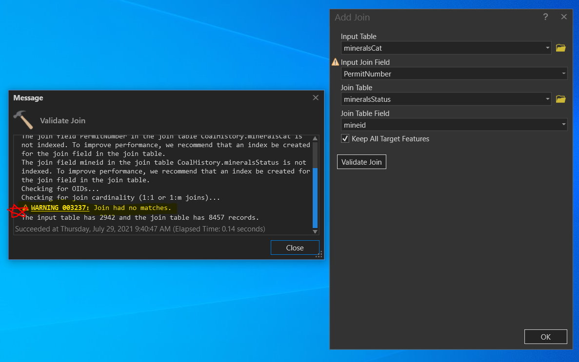

  • Saying, "Who cares if it doesn't validate. Let's see what happens." Then, as expected received null values for the join relating to the joining table

Screenshot showing that the field types are the same:
Screenshot showing the warning about no join matches:

GregWyatt
It could just be because you are showing a subset of the data, but I am seeing an extra leading zero in the mineralsCat table that does not exist in the mineralsStatus table.
M00100001 vs
M0100001
GregWyatt
M00100001 vs
M0100001
cschooley
Oh, shoot. What a silly thing to miss. Thank you.
