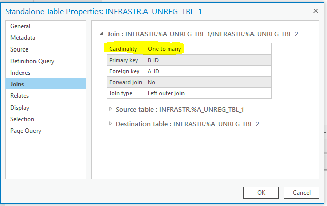

But regardless, Pro will tell you what kind of join it used in the layer properties:
Just a heads up: One-to-many joins in ArcGIS Pro are quite buggy. You might find you need to export to a static copy (such as a separate feature class within the same geodatabase) in order to use the joined data in Pro.
