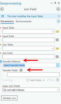

In the newest version of Join Field, the Transfer Method has been exposed.
So the help topic helps to clarify what happens if you select a field rather than use Field Mapping
  • If the Select transfer fields option is specified for the Transfer Method parameter and field values in the Join Table Field parameter value are not unique, only the first occurrence of each value will be used. To account for values other than the first occurrence (a one-to-many join), set the Transfer Method parameter to Use field mapping. To perform a one-to-many join, the Input Table parameter value must have an Object ID field and be in the same workspace as the Join Table parameter value.
Join Field (Data Management)—ArcGIS Pro | Documentation
