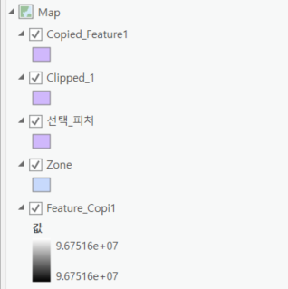

I got a problem in using the model builder of ArcGIS Pro. I made a very simple model using the iterator (Iterate Feature Selection). It seems working good - I got all outputs saved in the gdb and everything opened well. However, the thing is that having listed those outputs on the Contents is not available.
I could only see that the very first outputs are on the Contents while the rest is just saved in the gdb. I want all of my results showing on the Contents. Please give me a hand if anyone knows how to fix this.
