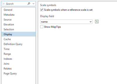

Neal_t_k
MVP Regular Contributor
Not sure if I am following correctly, but this may help. Labels are kind of wonky with KMZ and google earth, but I have had luck with changing the display text in the layer settings to be what you want the label to be and then export to KMZ:

Neal_t_k
