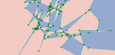

Working with fire perimeter data submitted to me, and came across this mess.  Any suggestions for easy ways to clean up? Repair Geometry didn't do much to improve...Thanks!

try a convex hull from
Minimum Bounding Geometry (Data Management)—ArcGIS Pro | Documentation
your points don't appear to form a polygon or do they?

You could try using feature to polygon in tandem with smooth polygon to clean the area.
