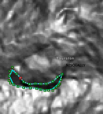

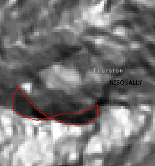

Hello mapping community,
I've done this type of editing in ArcPro for a while but this is a new issue I’ve encountered recently:
When digitizing a polygon, the vertices automatically snap together when they are nearby. The drawn polygon on the left became the polygon on the right when I finished the sketch. I tried this with snapping on, snapping off and various snapping tolerances. All produced the same result.
I checked the coordinate system for my map and the feature class are in the same projection.
Are there settings that would be causing my polygons to behave this way?
Thanks,
Emilie

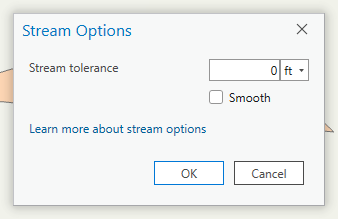

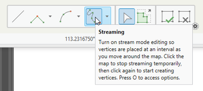

Scott_Harris
@EmilieRichard5
It looks like you are using the Streaming construction tool. Is that correct? It looks like this on the toolbar:
If so, check the tolerance values for that tool by right clicking on the map (while the tool is active) > choose Streaming Options:
... and change the tolerance to a value that makes sense for your data:
EmilieRichard5
I've not been using streaming construction, just adding vertices by clicking along, but thank you for the reply.
