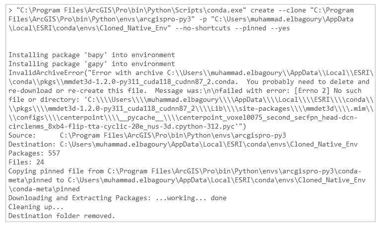

Hi all,
I’m encountering an issue while trying to clone the ArcGIS Pro 3.5.2 Python environment using the Package Manager on a fresh Windows install. After installing ArcGIS Pro 3.5, updating to 3.5.2, and adding deep learning essentials (all without errors), I attempted to clone the arcgispro-py3 environment. However, I received an InvalidArchiveError along with messages about a missing file.
Any suggestions on how to resolve this? Could it be a corrupted installation or a permissions issue? Thanks for your help!
