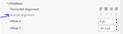

I am using ArcGIS Pro to update some of our old poster maps. I am trying to dynamically label individual detail maps on the poster. I have a title for each of the detail maps in a "rectangle text" item. I'd like the text in this item to be vertically centered. Based on the Format Text dialog, this seems to be possible. In fact, it works for regular text, say with a marker background, but not for rectangle text items. Am I missing something?

Was asked to help print a paper map, why is the Vertical alignment disabled?  I am on Pro 2.9.5, it seems I have to eyeball the Offset Y.

Its disabled because it is not a valid setting given the context. I provided a link in the previous post (10-20-2022 06:13 AM) that explains this situation. Are you able to access this post? If so, do you have any specific question concerning the explanation?

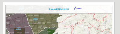

What is the best way to add a "Title" to the print layout?  I am trying to recreate the image below.
If I don't use the eyeballed Offset Y, I get the text at the top of the box, which is not desired.

There is no one "best" way to add a "Title". It all depends on what you want to do.
There are 2 basic graphic text element types: Straight text elements (and curved text) and polygon text elements (rectangle, circle,. etc..). The help topic Add graphics, text, and pictures in a layout provides more info. If you are not interested in the text wrapping into new lines (within the bounding box that you initially drew when inserting the legend) I would use straight text and just create a graphic rectangle for the "box".
