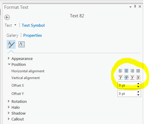

I am using ArcGIS Pro to update some of our old poster maps. I am trying to dynamically label individual detail maps on the poster. I have a title for each of the detail maps in a "rectangle text" item. I'd like the text in this item to be vertically centered. Based on the Format Text dialog, this seems to be possible. In fact, it works for regular text, say with a marker background, but not for rectangle text items. Am I missing something?

The vertical alignment still seems to have no effect in a rectangle box.
