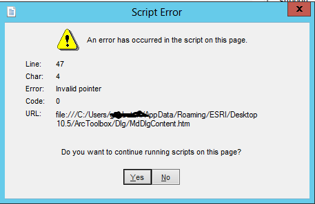

The same will happen when I repair the install, so If i repair data interop for Pro, data interop for desktop stops working and vice versa. In data interop for desktop i get the following script error:

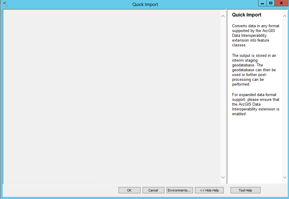

After clicking yes the tool stays empty:
In Arcgis Pro the tool is not empty but it's impossible to browse for the dataset.

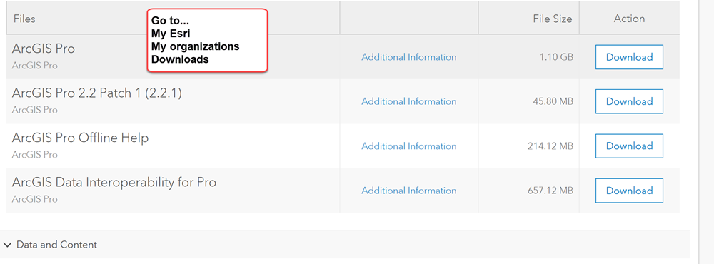

Thanks for your help but I have already installed the 64-bit version which I downloaded from my.esri.com
