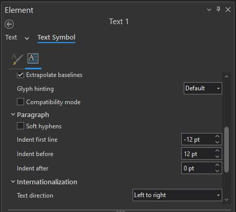

I contacted ESRI technical support about this matter. You can create hanging paragraphs in ArcPro using the following commands.
  1. Right-click on Text from Contents pane and select Properties.
  2. In the Text window > select the Text Symbol tab > choose Formatting.
  3. Below Paragraph Change the Indent first line to -12 pt and Indent before to 12 pt.
