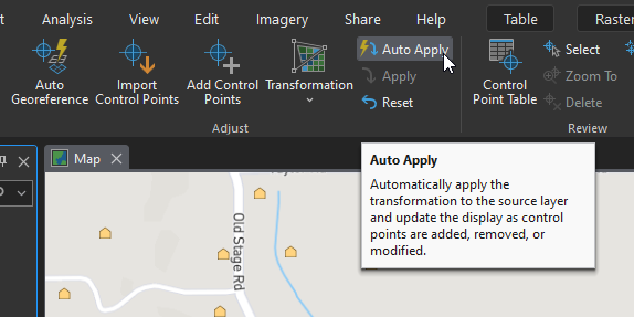

Someone recommended to turn off Auto Apply - which seems like it should help, but in the end, it doesn't.  If I turn off Auto Apply, I zoom back and forth between the layers, and I can add a number of well-distributed control points - but then when I try either the Transformation or Apply, everything just disappears.

DavidForbuss1
Click this button to turn off the auto apply.  It works almost identically to ArcMap.  I usually just bookmark my source/destination so I can hop between them when building the points table.
AvaFarouche
Thanks!!
Well, that seems like it should help, but it doesn't. I still can't get it to work. But, one step closer?
