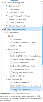

DanPatterson
MVP Esteemed Contributor
Just check for the locks in ArcToolbox to see .  In my case I don't have any "referencing" extensions, so a lot of functionality is impeded.
