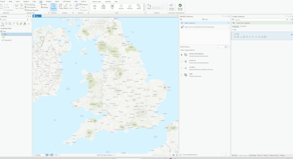

Outside goes to where...infinity. How do you map the edge infinity? You can't! Create a new polygon layer , create a rectangle that encompasses everywhere you are going to map. Then use the editor clip tool to clip out your polygon, the resulting polygon you can shade. Never clipped out a hole from a polygon then read the help file here.
PeterGardner
Duncan
Many thanks for your helpful response. I have read the help file for clipping, but am still unclear of the settings. If I click "clip all editable features" and Discard (Remainder) which says it should just delete the areas that intersect, which should be right, but it deletes everything. If I don't select "clip all editable features" it is stuck Selecting Features for the last four and a half hours.  It is frustrating for something I can do in 15 seconds in QGIS.

Many thanks. Each time I clip it deletes the duplicated area out of the original map rather than out of the rectangle. I am trying to colour the sea around Britain, each database I can find of the sea is not precise enough for my purposes so I am using the Ordnance Survey Boundary Line data which runs down to the low water mark.

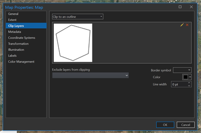

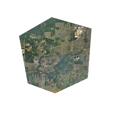

Go into the map properties, there's a tab for clipping. Select "clip to an outline", then pick your layer. That's it!
Or did you mean something else by "shade", like fading the other areas?

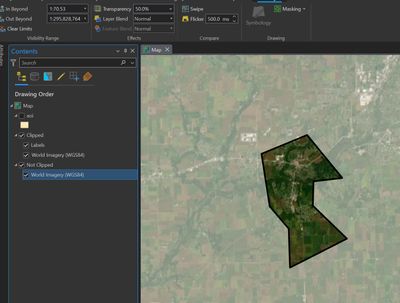

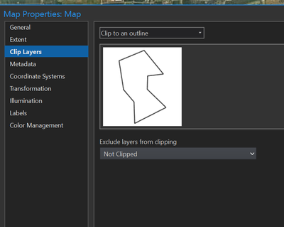

Well, it would be incredibly hacky, but what about duplicating your map layers, excluding some from the clip, and changing the display? Here's imagery added twice, but the non-clipped version has 50% transparency.
jcarlson_0-1728074892815.pngjcarlson_0-1728074892815.pngjcarlson_1-1728074904620.jpegjcarlson_1-1728074904620.jpeg
It's a far cry from Q's "inverted polygon" symbology style, that's for sure.
An opposite strategy would be getting a global-coverage layer like Jon Nelson's global blank basemap, then using layer masking to mask out the area of interest.
