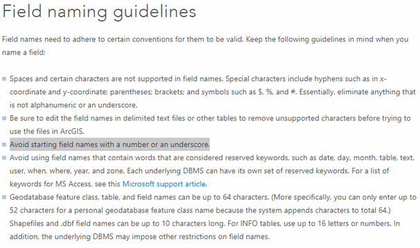

Is it possible one of your field names is a reserved word?  Each DBS has there own set of reserved words.
MySQL Reserved Words
ESRI File Geodatabase Reserved Words
MS SQL Reserved Words
ORACLE Reserved Words
PostgreSQL Reserved Words
MS Access Reserved Words
Also make sure none of your field names start with an underscore.  I was not aware of that one until recently.
You note 5 fields of ~45 work, try groups of fields until you get an error.  Then look for possible issues in that group.  Note, there may be more than one field that has an issue.  If you can post a list of the ~45 fields it, may be helpful for for someone to review them.
