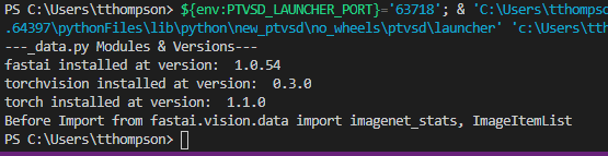

Some progress on this. I believe this issue is related to the _data.py file. Something, at least on my machine, is causing the import statements within the try/except to stop working.
Specifically, it is the import statement:
from fastai.vision.data import imagenet_stats, ImageItemList
Any statement defined after this line is skipped and fails, and so an exception is thrown and HAS_FASTAI will always equal false.
Interestingly, the interpreter throws no errors. It just exits and appears to have executed successfully. My debugger wasn't working, so I implemented some print statements to test.
try:
 print("---_data.py Modules & Versions---")
 import fastai
 print("fastai installed at version: ",fastai.__version__)
 import torchvision
 print("torchvision installed at version: ",torchvision.__version__)
 import torch
 print("torch installed at version: ",torch.__version__)
 print("Before Import from fastai.vision.data import imagenet_stats, ImageItemList")
 print("After Import from fastai.vision.data import imagenet_stats, ImageItemList")
This is quite bizzare.
What do you guys think?
Tom
