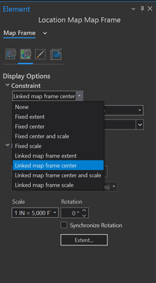

*I should have included that you will first need to insert a new map frame before an inset map can be linked. After that, the instructions below will make more sense.
Right click on the inset map frame from the contents pane, then chose "Properties." From the elements pane click the "Display Options" icon, and from there you can choose your "Constraint" option. Options that include the word "linked" (though each perform a different linked functionality) will accomplish what you need. "Linked map frame center" or "Linked map frame center and scale" will most likely be your preferred options.
