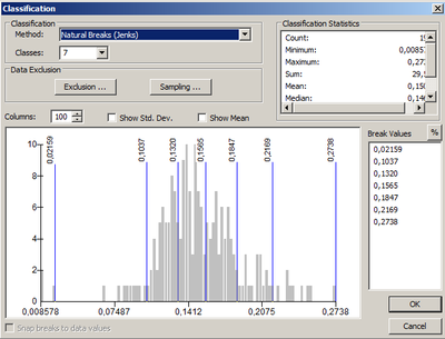

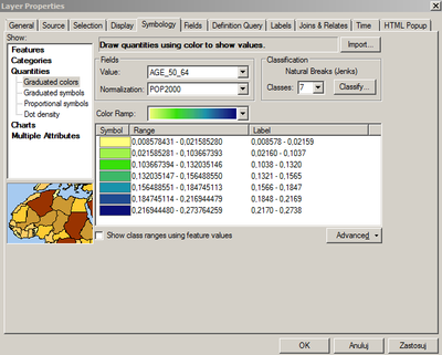

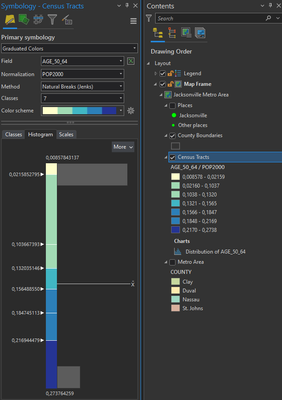

There is a known problem of very poor presentation of variable distributions in histograms in ArcGIS Pro. However, I did not expect that there were also such serious substantive errors.
ArcGIS Pro Ver: 3.1.3
Variable: AGE_50_64
Classyfication by natural breaks method (7 classes)
Normalization by POP_2000 variable.
Fig. 1. Normalized classyfication in ArcGIS DesktopFig. 1. Normalized classyfication in ArcGIS DesktopFig. 2. Arc GIS Desktop histogram of the Fig. 1 populationFig. 2. Arc GIS Desktop histogram of the Fig. 1 populationFig. 3. ArcGIS Pro histogram the same normalized population as in Fig. 1Fig. 3. ArcGIS Pro histogram the same normalized population as in Fig. 1
I suposse it is the serious application error.
Is there any other possible to make histogram of the normalized data in ArcGIS Pro (f.e. by Create Chart)?

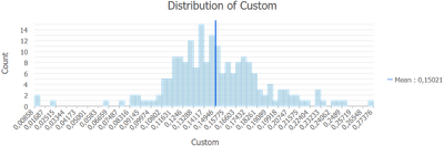

Although not as simple as in ArcMap, you can still easily achieve this by opening up the Charts Properties dialogue box as discussed before, then on the far right of the Number drop-down option, click on the "Set an expression" button. Then in the Expression Builder simply double-click on the field Age_50_64, then divide (backslash) and then double-click on POP2000. This will create a histogram with the normalized data you are looking for.
TomaszBartus
Thank you for the good advice. Of course it worked. The histogram of the normalized variable (Figure 4) is very similar to Figure 2.
Fig. 4. ArcGIS Pro histogram of the normalized AGE_50_64 variableFig. 4. ArcGIS Pro histogram of the normalized AGE_50_64 variable
However, the question remains why ArcGIS Pro draws such nonsense as in Fig. 3???
Regards
MervynLotter
MVP Regular Contributor
The coloured line and histogram in Figure 3 is based on the Natural breaks classification that you chose. Try changing the classification method to Standard Deviation. The purpose of their "histogram" is to help find the necessary symbology breaks and how these may impact on the data when visualised on a map.
TomaszBartus
OK, but the distribution of such a large population and close to normal should in no way be illustrated with two bars. This is an obvious software error. Let's leave the topic aside because I don't do research, I only prepare exercises for students.
