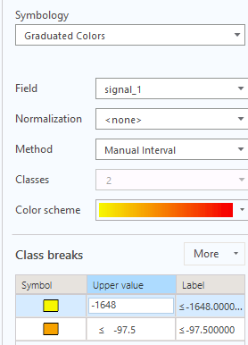

In the Symbology - Graduated Colors - Method (Manual Interval), I cannot modify the existing Upper Value to anything but a whole number.  In the screen shot below, I started with another method by default and changed the Method to Manual Interval.  Both values had decimals in them.  When I tried to change those values, it would not let me add a decimal.  In fact, when I deleted the tens decimal place, the decimal disappeared along with the tens position number without another backspace press.
Is there a setting that I have to find and change?  If not, this should be a bug entry.

Hi Adam,
I was unable to reproduce this issue with the data I have. Would it be possible for you to share your data that can reproduce this issue? If you could, email me a zip file containing a small dataset. Also, are you using the Final version of Pro 1.0 or a Pre-release. We did fix an issue similar to this for the final release.

AdamRepsher
Hi John,
My previous results were with the Pre-Release version. I just checked today with the first full release and the issue is gone.
