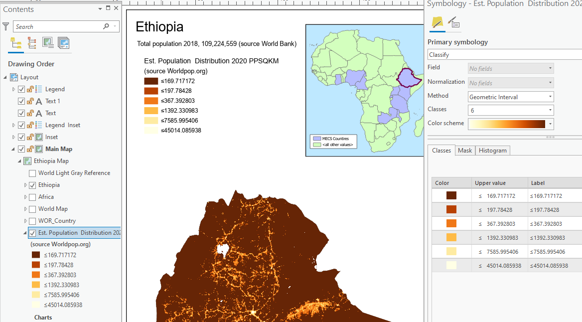

This is a screen capture of a map with a raster in ArcGIS Pro 2.5.1.  I clicked the circle area in the upper right of the map... and the pixel value shows it should be the darker colors (76.7)...  I know that the reverse ordering bug was allegedly fixed in this release (Esri: “BUG-000128246), but I am still seeing problems with it.

The first screenshot shows the map correctly symbolized after I chosse a color and classification scheme:

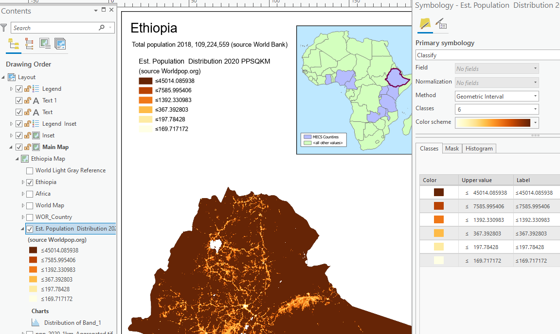

The 2nd shows what happens if I use More>Symbols>Reverse Order, still technically correct but it only chanegd the color order not the values.
So to try and get the correct order of values I choose More>Reverse ordeing and in the contents layer legend, symbology panel and map legend I get the desired order for colours & values but the map data itself now incorrectly shows darker areas as high values etc (see first screenshot for correct map values).

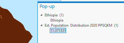

the pixel value of the centre of this extracts dark area is 11.37 so should be in the last class <169.71

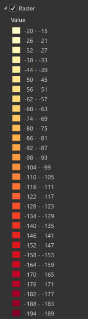

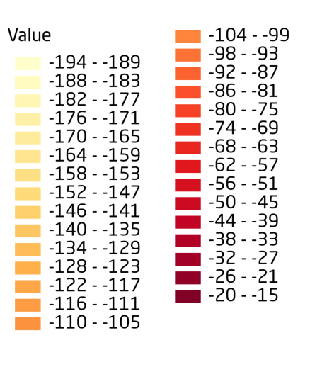

Was this ever resolved? The same issue is apparent in 2.8.1 Legend.pngSymbology.png
