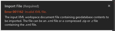

My coworker gave me a surface from CAD and the file type is XML.
I want to open the file in ArcPro, then create a map tile package of the surface to publish it in AGOL to view in a web map.
I am getting this error message:
Luke_Pinner
MVP Regular Contributor
Your .xml file is a LandXML surface.  If you have the 3D Analyst extension licensed, you could use the LandXML to TIN tool to import it.

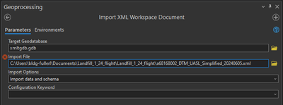

L77
@DanielFox1 I moved the xml file to a different location that doesn't have a hyphen, but it still has the same error.

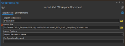

L77
I am using ArcPro 3.2.1.
I tried adding other xml files that our engineers are using in CAD and they all seem to get the same error message.

The tools for working with XML Workspace Documents don't work for any XML file, they work for one very specific Esri format of XML data.  An "XML Workspace Document" is a geodatabase that's been converted to XML, a CAD file exported to XML wouldn't be using that same XML schema.
