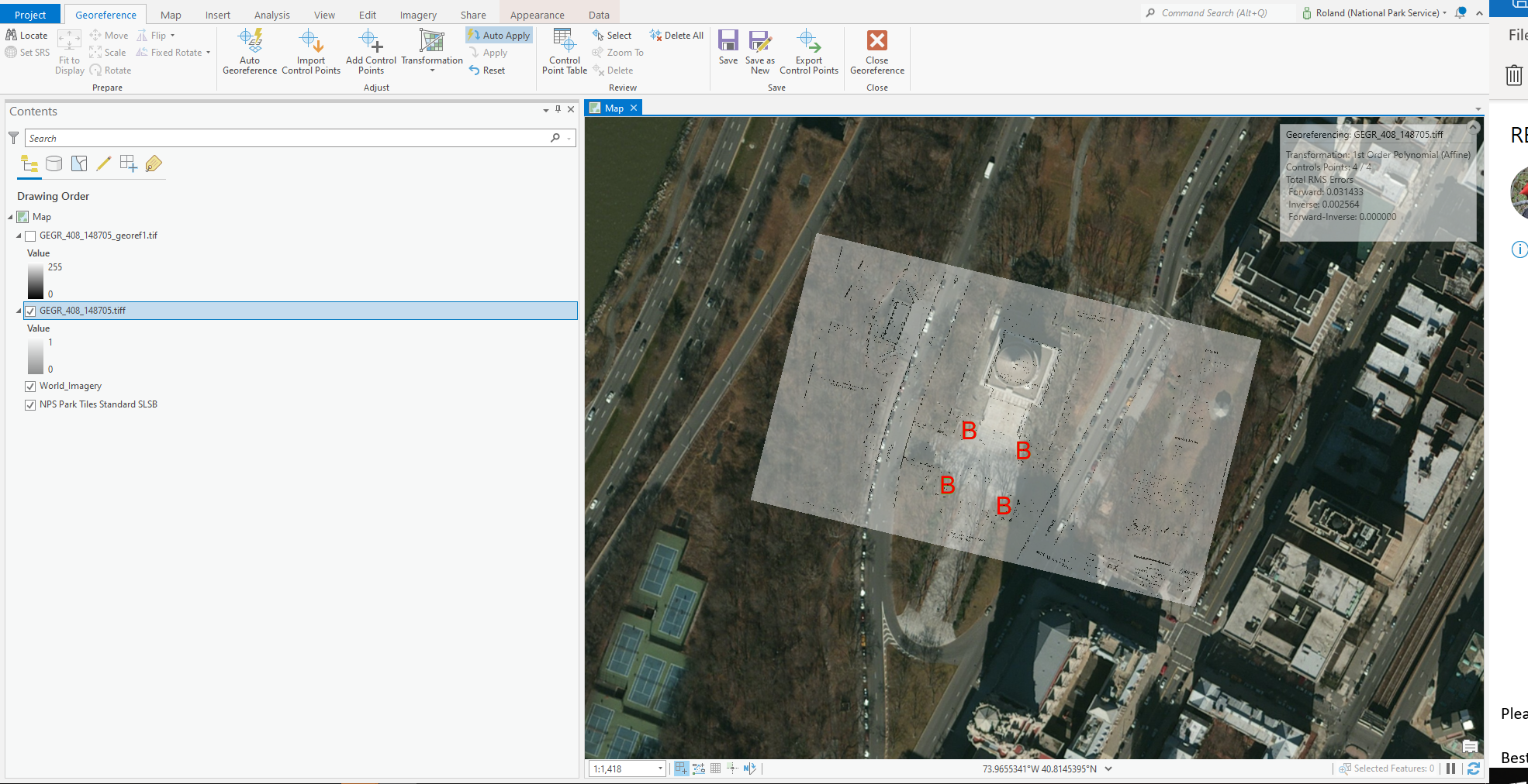

I am using the "Georeference" functionality in ArcGIS Pro version 2.8.  After importing my control points from a previous session of ArcGIS Pro, the graphical representation of the control points appear as large B's instead of crosshair symbols.  I have included an image of what I see.
I was wondering if I could change these symbols to a different symbol?  It doesn't appear that I have control over these.

This looks like you don't have the ESRI fonts installed on your C drive. ArcGIS symbols are defined by characters. If you haven't got them installed, the software replaces with the equivalent in a system font.

Perfect.  The fonts hadn't installed when Pro 2.8 was installed.  Copying them from the Esri fonts to the system fonts folder resolved the issue.
