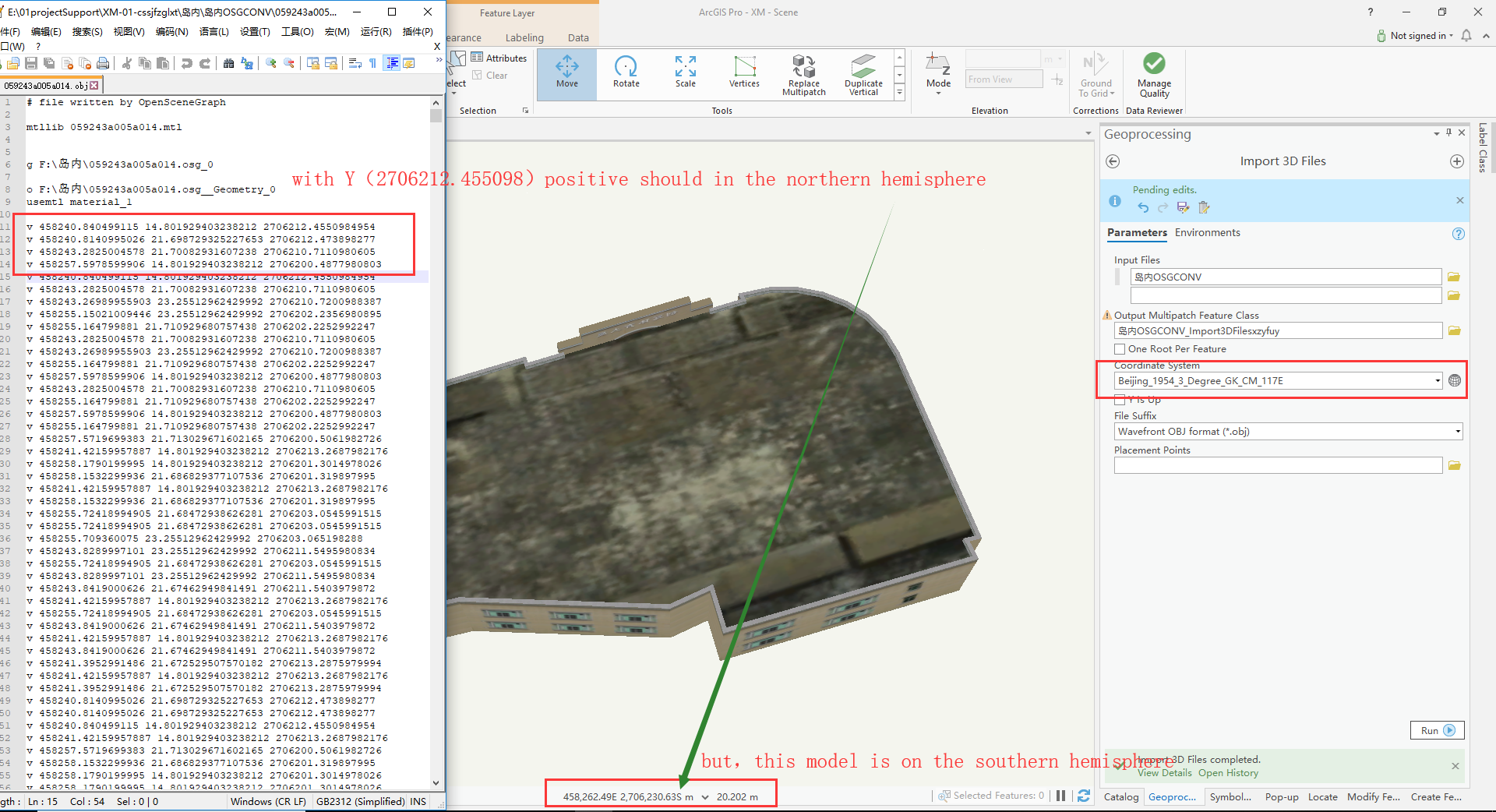

arcgis pro,”import 3d files“  tool imports *.obj files with wrong location
eg : Y axis is positive(should on the northern hemisphere) but on the southern hemisphere(turn upside down about equator)
LoutKuiper
Did you ever find a solution for this MossizeMossize Wang? I am facing the same issue.
