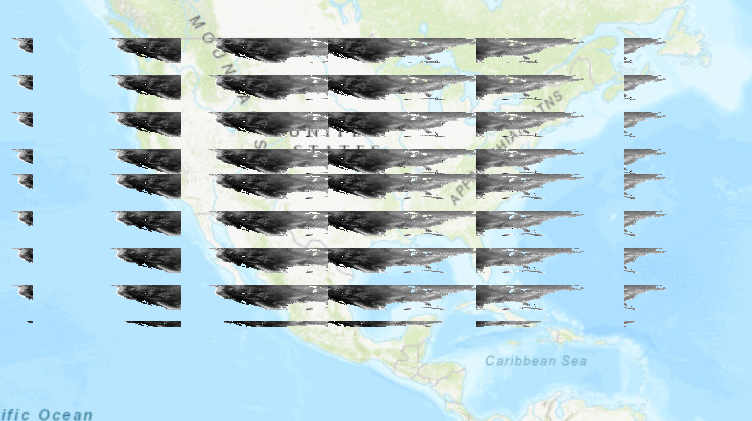

I ran into another Imagery Layer raster analysis issue, appreciate if you can provide any help.
I am using ArcGIS Pro's "Resample" raster function to resample an imagery layer (time enabled). I run the resampling using Image Server raster analysis, result is saved as Imagery Layer (hosted).
When I use "Bilinear" ResamplingType, it works, but it does not work with "Average" and produces a really bad result like the following one.
