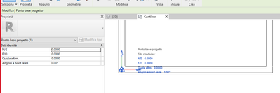

Hello,
I'm trying to import an IFC File in ArcGis Pro, but the position and the scale of the elements whitin the file are uncorrect.

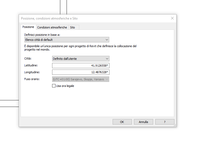

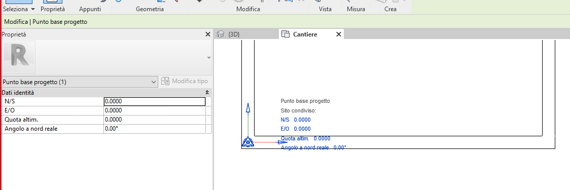

I made the model in Revit and I have set the survey point to a specific latitude (41.9126558°) and longitude (12.4876328°) and the project point on 0,0,0 and this two point are extacly one on top of the other.

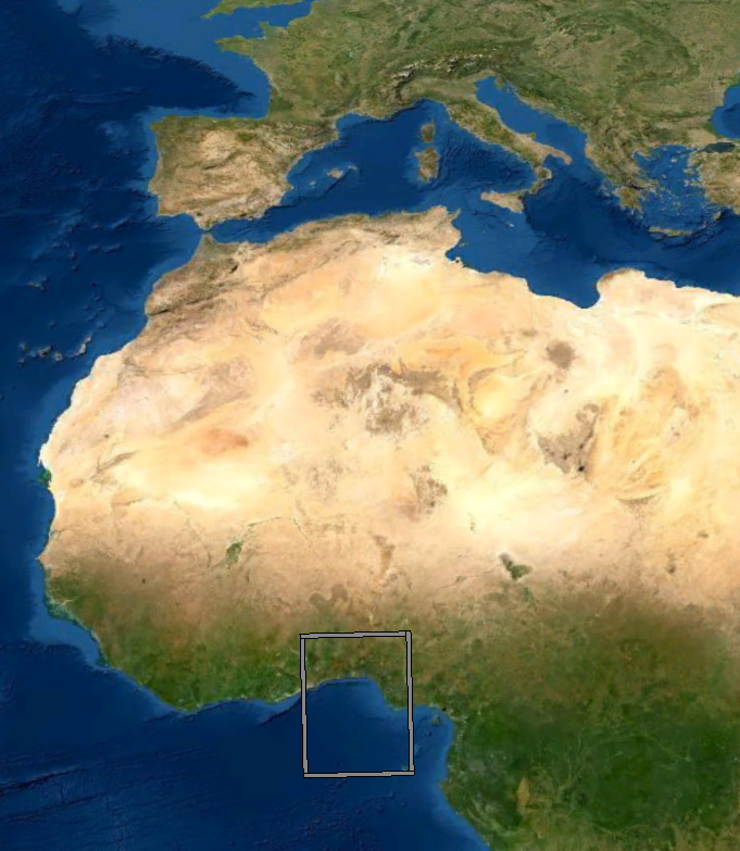

Now, when import the Ifc file in ArcGis Pro the building position is in the latuditude and longitude 0, why?
And I have a wrong scale of the building.
In the ArcGis Pro my map has WGS 84 like coordinate system and Ifc file has the same coordinate system, but the result is:
The building is in Afric with a giant scale and not in nearby of center of Rome.

The issue is that the survey point does not carry any relative information relation to X,Y and also, on your screen capture you are not adding any information to the Survey Point or Base Point. You are adding the location information (Lat and Long) to the weather station information which Pro does not uses and when exported to IFC is also ignored.
You can do two things
1. Export the way you are doing it right now and do a full georeference
2. Defined the coordinates (X,Y) for model (revit) and export it to IFC.
Remember Revit only works with metric or imperial units  (NO --> Lat or Long)
