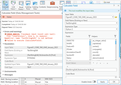

Can anyone help me?  way I can't use SQL in my ArcGIS pro, they always show me this message

Ah, yes.  Should have caught that from the original question...
From the Calculate Field help: "SQL expressions were implemented to support faster calculations for feature services. Instead of performing calculations one feature or row at a time, a single request is set to the feature service, resulting in significantly faster calculations.
Only nonversioned feature services support SQL expressions. For other formats, use Python or Arcade expressions."
And now the error is referenced on the thread: https://pro.arcgis.com/en/pro-app/tool-reference/tool-errors-and-warnings/001001-010000/tool-errors-...

Rajeshmadhaiyan
Can anyone help me?  way I can't use SQL in my ArcGIS pro, they always show me this message.
I have using annotation feature class layer in ArcGIS Map now i am migration to ArcGIS pro for Existing Sql "[TextStringEdit] &vbnewline & [Post]" not working ArcIGS pro field calculator but it's showing python 3 and Arcade only not showing SQL.
I am getting errors below

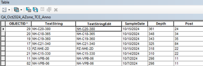

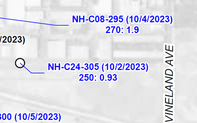

Rajeshmadhaiyan
Hello, JesseCloutier
I need one help from you. Regarding  Tags label annotation:
mentioned below the annotation table.
Need Output: annotation please check attached below screenshot
NH-C20-380 (10/15/2024)
 361: 24
Thanks,
Rajesh M
Rajeshmadhaiyan
Hi Team,
I need one help from you. Regarding Text Tags label annotation:
 361: 24
Thanks,
Rajesh M
