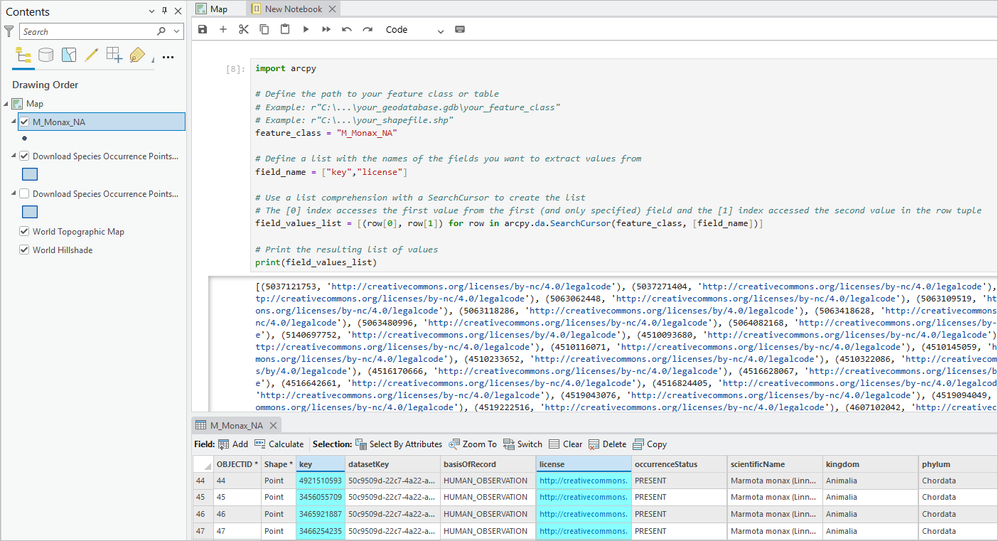

The first step would be to load the unique ID and URLs from the table into a list of tuples:
My data has a key field and a license field. The idea is, get both values, so when you check the URL, if it fails, you can make a list of the features that you need to go back and fix.
import arcpy
# Define the path to your feature class or table
# Example: r"C:\...\your_geodatabase.gdb\your_feature_class"
# Example: r"C:\...\your_shapefile.shp"
feature_class = "M_Monax_NA"
# Define a list with the names of the fields you want to extract values from
field_name = ["key","license"]
# Use a list comprehension with a SearchCursor to create the list
# The [0] index accesses the first value from the first (and only specified) field and the [1] index accessed the second value in the row tuple
field_values_list = [(row[0], row[1]) for row in arcpy.da.SearchCursor(feature_class, [field_name])]
# Print the resulting list of values
print(field_values_list)

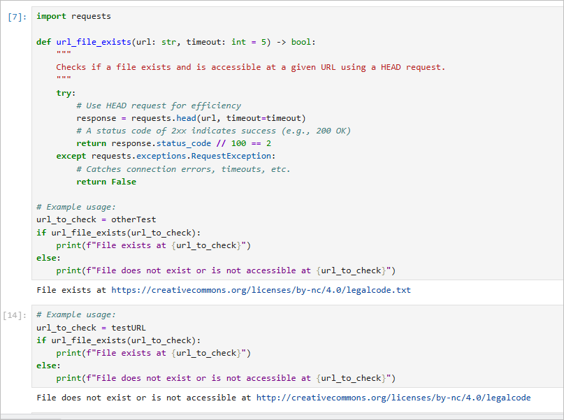

Once you have the list of tuples of ID and URLs, you can get one to test with.
The notation field_values_list[0] gets the first pair from the list, and the [1] after that gets the URL (which is the second item, after the key value in the tuple).
This URL in my data didn't work so well as an example, as it didn't have a file name, so I found the equivalent version of that page as  plaintext.
Once you have a URL, you can use the requests library to test if there is a file there.
import requests
def url_file_exists(url: str, timeout: int = 5) -> bool:
    Checks if a file exists and is accessible at a given URL using a HEAD request.
    try:
        # Use HEAD request for efficiency
        response = requests.head(url, timeout=timeout)
        # A status code of 2xx indicates success (e.g., 200 OK)
        return response.status_code // 100 == 2
    except requests.exceptions.RequestException:
        # Catches connection errors, timeouts, etc.
        return False
# Example usage:
url_to_check = otherTest
if url_file_exists(url_to_check):
    print(f"File exists at {url_to_check}")
else:
    print(f"File does not exist or is not accessible at {url_to_check}")
Once you have the url_file_exists function defined, you can run it in a loop on the list and do things conditionally, depending on whether it found a file or not.
