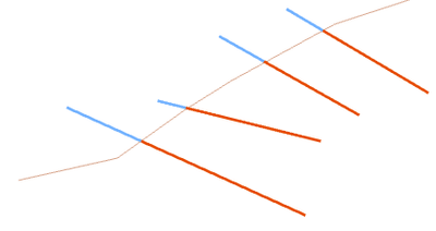

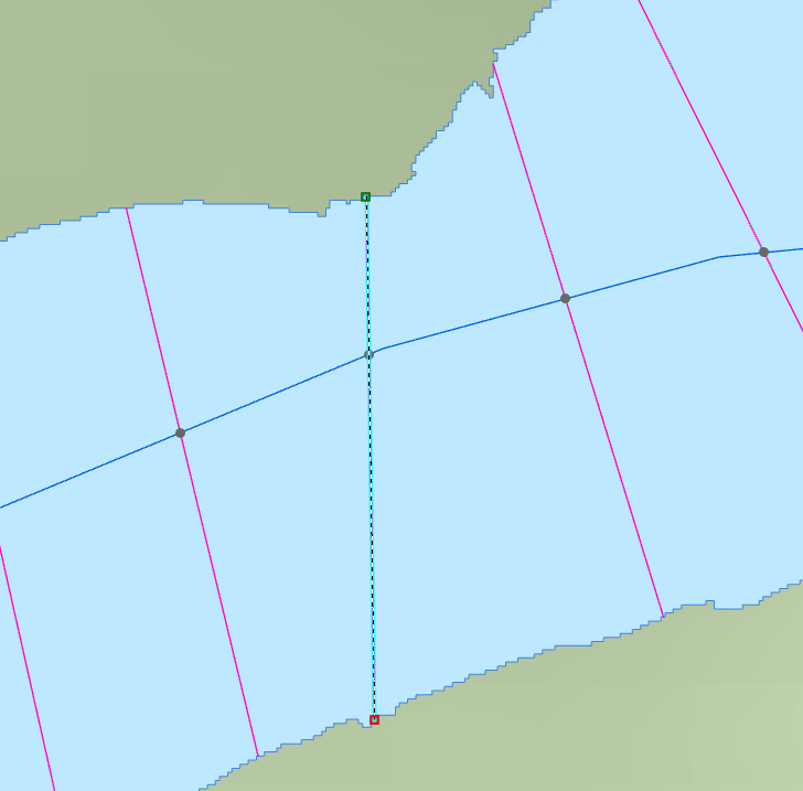

To set the scene, here is my data. The purple cross section lines are compose of two vertices and they always intersect the black point on the blue line, but note there is no vertex at that location. I show one line selected in edit mode to prove this.

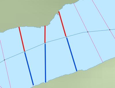

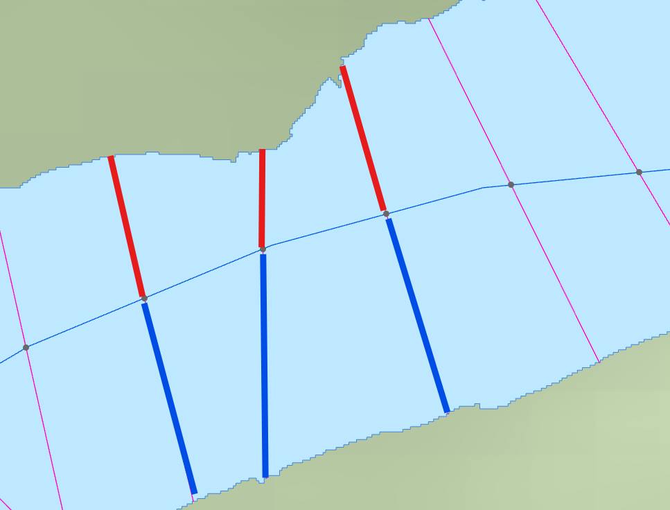

I want to use one of the many cool symbol effects that ArcPro has to create a two colour line, say going from red to blue changing colour at that black point, something like below.
Now one approach, because I know no better, is to actually split the line at the black point and colour up individually, but I don't want to do that, I want my line whole, composed of only two vertices intersecting the black point.

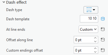

Since you're storing the percent along from the start of each line to the point, you can use the Dash effect to produce this effect. For accurate results, ensure your data is in a projected coordinate system appropriate for your map extent.

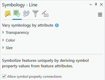

To start, Allow symbol property connections from the Symbology pane.
Next, go to the Primary symbology tab, expand the Dash effect expander, and click the data connection icon next to Dash template.
Paste in this Arcade expression that calculates how long the dash and gap should be based on the percent along field. If your data uses units other than meters, adjust the expressions accordingly.
//Calculate how long in map units the first dash should be (my data is in meters)
var dashMapMeters = $feature.Shape_Length * ($feature.PercentAlong / 100);
var gapMapMeters = $feature.Shape_Length - $feature.Shape_Length * ($feature.PercentAlong / 100);
// 39.3701 inches in 1 meter
var dashMapInches = dashMapMeters * 39.3701;
var gapMapInches = gapMapMeters * 39.3701;
// 72 points in 1 inch
var dashMapPoints = dashMapInches * 72;
var gapMapPoints = gapMapInches * 72;
//The dash pattern uses diplay units points, so convert the map units to display units
var dashPoints = dashMapPoints / $view.scale
var gapPoints = gapMapPoints / $view.scale
//The Dash template is a string of numbers separated by spaces. First number is the first dash, 2nd number is the first gap.
return dashPoints + " " + gapPoints;
 Set the At line ends property to Custom.
For the different color line on the other side, duplicate the layer in the structure tab and move it below the first dash line.
Then change the color and either remove the dash entirely, or keep it and modify just the last line of the Arcade expression to add a zero-length dash to start the pattern:
return "0 " + dashPoints + " " + gapPoints;
The resulting lines will adjust their lengths to match the map scale as you zoom in and out.

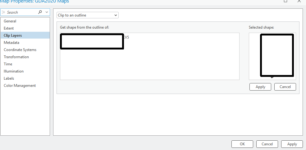

A very rough method would be to have a polygon that overlaps the part of the lines you want in one colour, and use it as clipping geometry in the map's Clip Layers properties.
Add the line layer to the map twice.   Exclude all layers except the top line layer from being clipped.
It will now look as if you have the lines nicely split at the boundary and you don't have to alter your 'important' data, just create a bit of supporting geometry in another dataset.

Thanks Jesse, you have earned yourself a 🍺!  I guessed this was a cartographic problem that could be solved with an effect, I was clearly on the right track but barking up the wrong tree!
So it was the dash effect I needed to tweak. I would not have known it was a conversion from metres > Inches > Points > Display Scale. So I think your solution will be valuable to others.

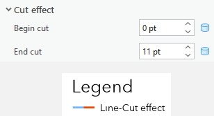

@DuncanHornby, I was focused on the dash effect because initially looking at your example it looks like a dash line, but you could also achieve this with the Cut effect like you asked about in your title.
Note that the Arcade expression is rather verbose so you can modify the unit conversions based on the units of your own data.
While the actual line effects are overridden by the symbol property connections, the legend patch in the contents pane uses the placeholder values so you can adjust those default values to influence how it appears in the contents pane or legend.

@JesseWickizer You have earned yourself another beer! Should be a good party at yours tonight. 😀 Tinkering around with the default values produced the desired patch, nice! Nothing wrong with verbose code , it makes it understandable in my opinion and that's a good thing.

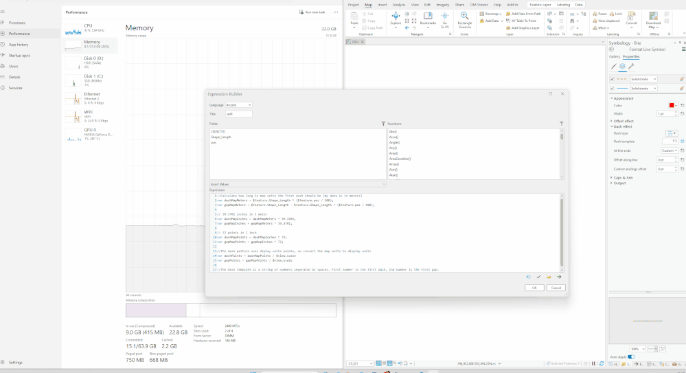

I have created a simple video of ArcPro blowing up when going into edit mode for a layer with this cartographic effect active. I think it is well worth you getting your developers to watch this as it proper  cripples the PC! Click on it to enlarge.
Watch how memory is instantly consumed to the max when you go into edit mode.Watch how memory is instantly consumed to the max when you go into edit mode.
This is a file geodatabase feature class containing exactly 1 line which I select and do nothing more than enter edit vertices mode. I have been able to replicate this on two different  machines.
